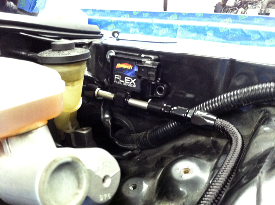

So the solution that Haltech uses is a GM modified flex fuel sensor that detects the Ethanol content in the return fuel line. Not what it is supposed to be….but what it actually is.
So plumbing would be as follows:
Fuel pump -> Filter -> Fuel Rail -> FPR-> Haltech Flex Fuel Sensor->Return line to tank

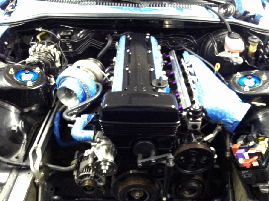

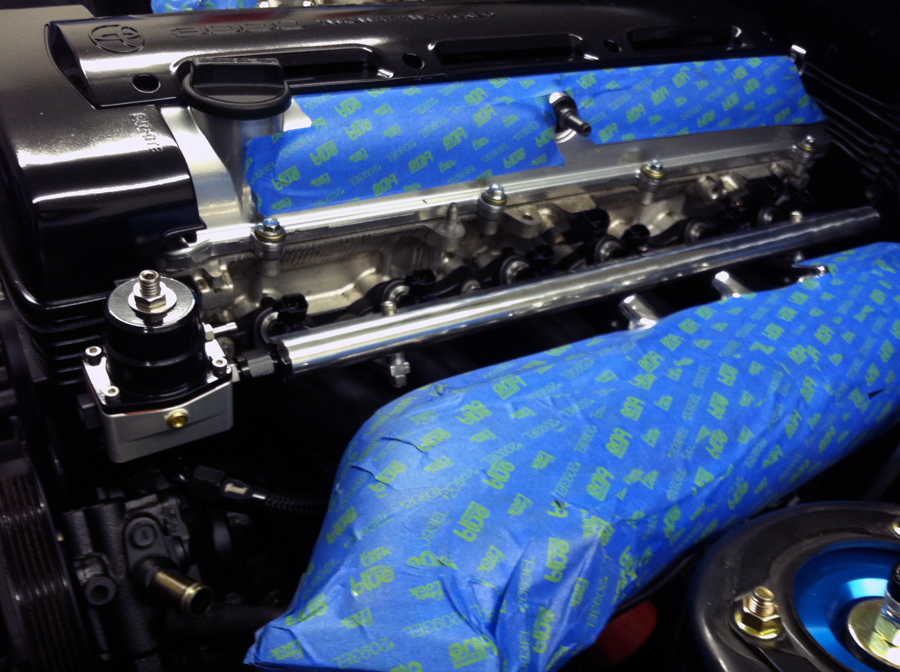

Here are a couple of pics of the setup on my Supra.
